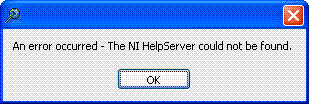

When LabVIEW starts up it launches a service called Help Server. This opens TCP/IP ports to communicate with other NI applications, namely the NI Example Finder. Sometimes, the ports that these applications access are used by other applications.
To fix this problem, there are different approaches:
