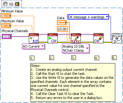

  3. If you are using LabVIEW, you can use the LabVIEW code below to send output current on multiple channels. Since the NI 9266 is a CompactRIO Module, this example program does not apply as it is using NI-DAQmx functions. However, the general setup for this task is similar and could be applied to the CompactRIO functions.
    • Select the correct device number of your current output device and appropriate channels for that device.
    • Assign between 0 and 20 mA to each current source that you are using.
    • Run the program. The current you measure between any of the current output channels and analog grounds is the sum of all the current sources that you have wired together.
