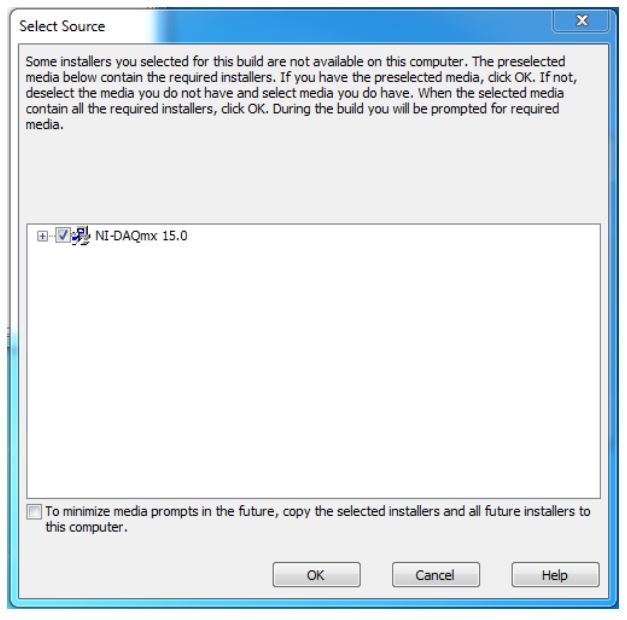

  • When trying to build an installer in LabVIEW I get the following error message:
Some installers you selected for this build are not available on this computer. The preselected media below contain the required installers.If you have the preselected media, click OK. If not, deselect the media you do not have and select media you do have. When the selected media contain all the required installers, click OK. During the build you will be prompted for required media.

Why am I getting this dialog prompt, and how do I include these additional installers in my build?
This "Select Source" dialog box is appearing because there are software installer dependencies missing for the build. In order to build a new installer that contains a particular product, files from the original installer media of the selected product are required. For example, if NI-DAQmx is being included installer, the Application Builder could prompt for Device Driver CD that contains NI-DAQmx.

When it comes to building an installer in LabVIEW, make sure the following settings are selected to avoid this dialog box in the future:
LabVIEW 2013 or Newer
Selecting the Copy all future installers to this computer when you run them checkbox will cause all future installers to run on the system to automatically copy their products into the local cache during the install. This will prevent future prompts for the location of those installers from within the Installer Builder utility.
LabVIEW 2010 - 2012
This dialogue can be avoided by selecting the Copy selected installers to this computer before building option in the Additional Installers window in the Installer Build Specifications.

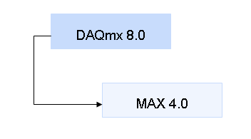

Some of these shared installer dependencies may have had a new version installed by another NI product and that product will be required in order to build the installer.
For example, say NI-DAQmx 8.0 is installed, which also installs NI Measurement & Automation Explorer (MAX) 4.0. As a result, NI MAX 4.0 will be installed on the computer.
Later Measurement Studio 8.0 is installed, which installs an newer version of NI MAX (4.1) and overwrites the previous version of NI MAX (4.0) (note: the version numbers of MAX are just an example and don't reflect real revisions shipped with various products). Now, NI-DAQmx 8.0 depends on Measurement Studio, and when an installer that includes NI-DAQmx 8.0 is built, it will need to copy the Measurement Studio installer from the distribution that installed it. So while Measurement Studio is not directly being included, a shared dependency that it updated is being included, and the Application Builder needs to copy the installer of that dependency.
