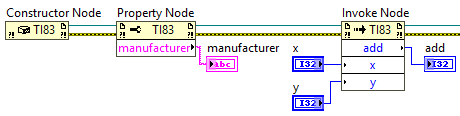

The reference node that is passed out of the .NET Constructor Node then allows you to access properties and methods in the assembly using Property Nodes and Invoke Nodes respectively as in the figure below.
