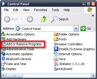

  1. Open the Windows Control Panel (Start»Control Panel)
  1. Open Add or Remove Programs

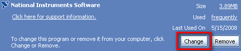

  1. Find National Instruments Software and select Change

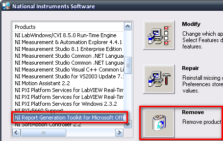

  1. Find NI Report Generation Toolkit for Microsoft Office and select Remove
  1. After the removal is complete, restart your computer
