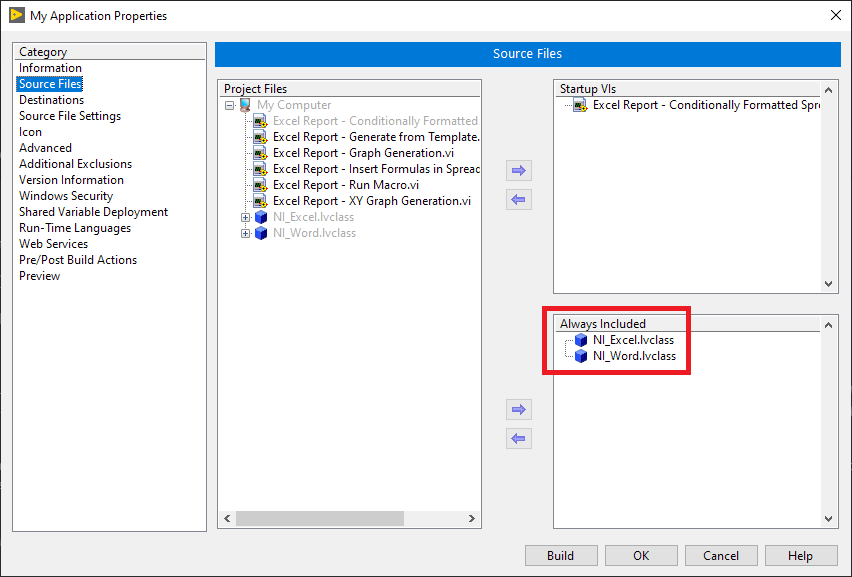

LabVIEW 2024 Q1
When building applications with Report Generation VIs, you must complete the following additional steps:
  1. Add the proper .lvclass files to your project
    1. If your application uses Microsoft Word, right-click My Computer in your LabVIEW project, select Add>>File..., and select the following file: C:\Program Files\NI\LVAddons\rgt\1\vi.lib\Utility\NIReport.llb\Word\NI_Word.lvclass
    2. If your application uses Microsoft Excel, right-click My Computer in your project, select Add>>File..., and select the following file: C:\Program Files\NI\LVAddons\rgt\1\vi.lib\Utility\NIReport.llb\Excel\NI_Excel.lvclass
  2. In the My Application Properties dialog box of the Build Specifications select the Source Files tab located on the left.
  3. Then, navigate to and select the .lvclass files you added to the project. After selecting the files, click the right arrow button located next to the Always Included box to add the class files to the Always Included list. This will add the class to the application.
Note: If the application you are building contains the MS Office Report Express VI, you must add any Microsoft Word or Microsoft Excel templates that you use to the LabVIEW project and to the application. You can do this by adding the templates to the Always Included list under the Source Files tab of the My Application Properties dialog box.

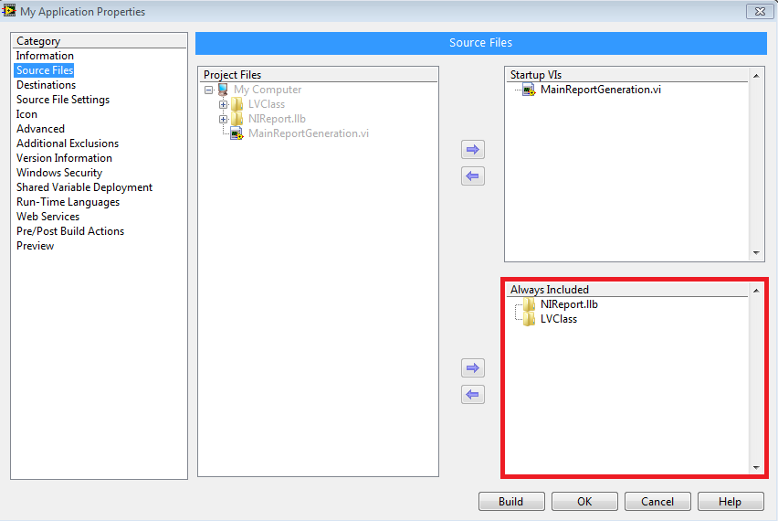

Versions of the toolkit with LabVIEW 8.6 and later use LabVIEW classes, which dynamically call VIs depending on what report type is being generated. In order to build an executable that uses dynamically called VIs, you must include these VIs in your build specifications.
  1. In your Project Explorer window, right-click on My Computer and select Add » Folder (Snapshot)
  2. Navigate to C:\Program Files\National Instruments\LabVIEW x.x\vi.lib\Utility\NIReport.llb or C:\Program Files(x86)\National Instruments\LabVIEW x.x\vi.lib\Utility\NIReport.llb (where x.x refers to the specific version of LabVIEW being used) and click Current Folder.
  3. Repeat the same procedure to add the LVClass folder by navigating to C:\Program Files\National Instruments\LabVIEW x.x\vi.lib\Utility\LVClass or  C:\Program Files(x86)\National Instruments\LabVIEW x.x\vi.lib\Utility\LVClass
  4. After you have the two folders in your LabVIEW Project, you can add them to the Always Included section of the Source Files category of the Build Specifications as in the picture below.

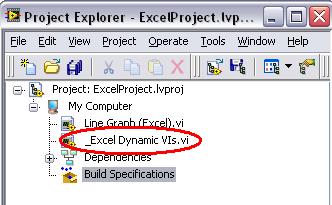

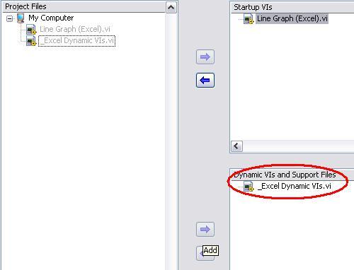

  1. Application Builder only lets you add files from your project therefore, you have to add this file to your Project Explorer first:
  1. Then you can add it as a dynamic VI inside the Application Builder:
