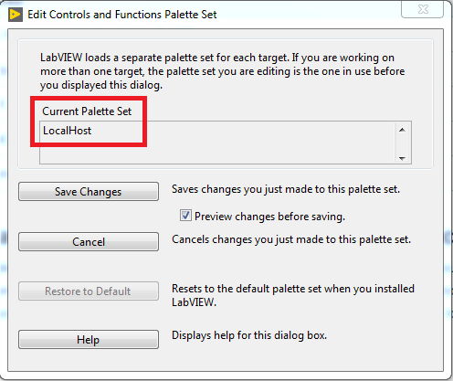

  1. Select Tools»Advanced»Edit Palette Set...
  2. Right-click into the palette menu bar or the palette space when in palette editing mode.
  3. Determine if the Synchronize Path is correct. If not select Synchronize With Directory once to remove the checkmark. Then select Synchronize With Directory a second time to select the correct directory.

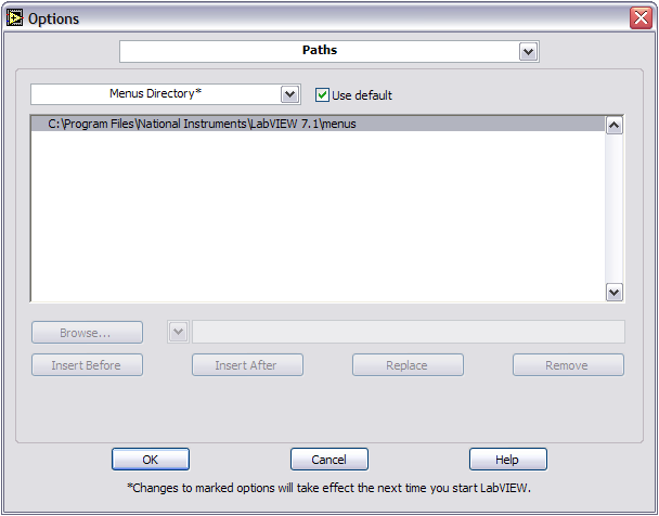

If you are using LabVIEW 7.1 or earlier, and the menus folder is not empty and is in the default location (<LabVIEW>\menus), but the palettes are still empty, the problem may be that the path to the menus directory is modified within LabVIEW. To check if this is the case, follow these steps:
  1. Navigate to Tools»Options, then choose the Paths category
  2. Select Menus Directory in the lower pull-down menu
  3. Verify that the Use default option is checked.

If the Current Palette Set in the Edit Controls and Functions Palette Set is something other than LocalHost, such as NI.RT.cRIO.901x, LabVIEW is referencing the palette on your real-time device rather than your local PC. Make sure that the LabVIEW Real-Time Module is installed and activated on your PC.
