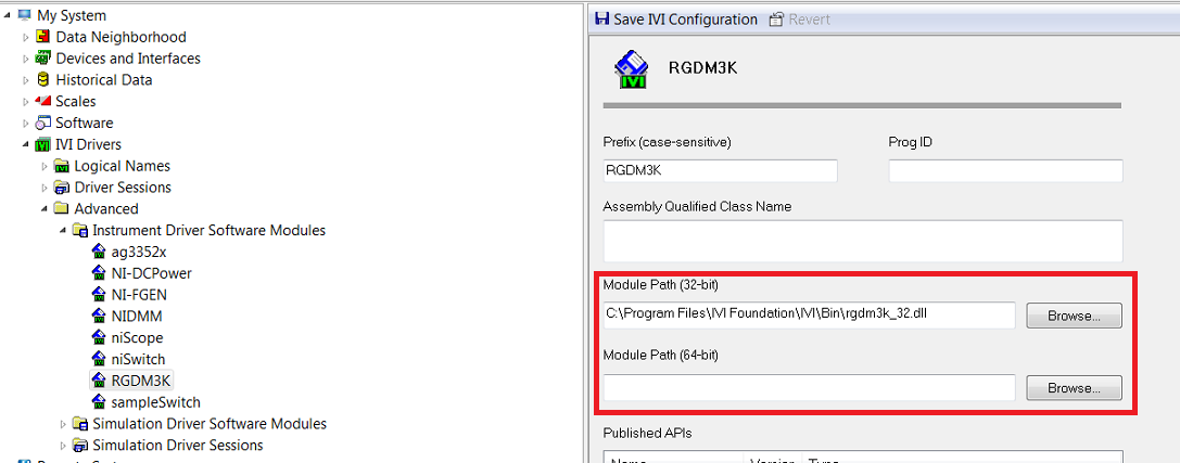

If using TestStand 4.0.1 or prior, consider the following additional steps:
1. If the IVI Compliance Package was installed from the NI Device Driver CD before installing TestStand, do not install the IVI components from the TestStand CD.
- Instead, disable the Basic IVI Class Drivers feature within the IVI Engine feature during the TestStand installation.
2. If the TestStand IVI components were installed after installing the IVI Compliance Package from the NI Device Driver CD, run the repair utility on the IVI Compliance Package.
- The repair utility can be found in the National Instruments Software Maintenance Utility located in Add/Remove Programs in the Windows Control Panel
Note: Versions of TestStand running on Windows Vista, Windows XP or Windows 2000 are no longer supported. To get assistance with troubleshooting, upgrade the PC and software to a newer version of Windows and TestStand.
