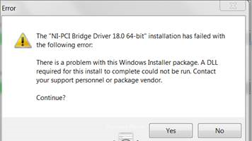

  • When I try to install NI software such as LabVIEW, I receive the following error:
What can I do to resolve this error?

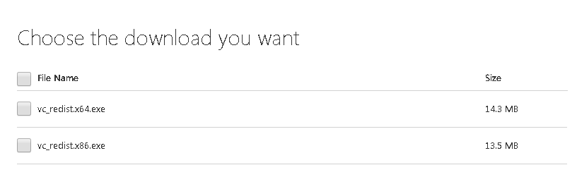

  1. Issues related to corruption of msvcp140.dll can usually be corrected by installing the Visual C++ Redistributable for Visual Studio 2015. If installing the redistributable itself doesn't work, you can try installing the latest update to it.
NOTE: When downloading the redistributable or redistributable updates, select the executable corresponding to the same bitness as your LabVIEW program, not your operating system. vc_redist.x64.exe corresponds to 64-bit LabVIEW, and vc_redist.x86.exe corresponds to 32-bit LabVIEW.
