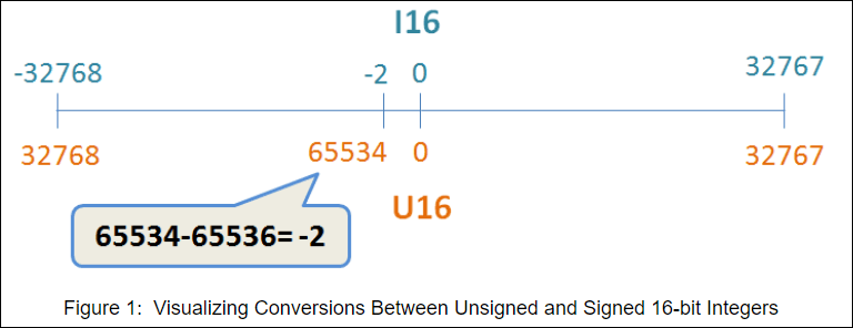

When you set the DAQmx Read Node to read Raw Data 1D arrays, you will get an array of integers. If your DAQ device has a resolution of 16 bits, you should set the DAQmx Read Node to Raw 1D U16 or Raw 1D I16 mode or you will lose effective bits. When the reading is greater than 32767 (2^15-1) in U16 mode, it means that the voltage is negative and this value is complementary code. You can convert it to a signed integer by subtracting 65536. For example, 65534 in U16 is -2 in I16. Keep in mind that unscaled Raw Data can differ between different series of DAQ cards.

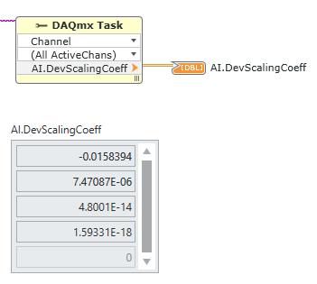

M Series and X Series:
For M Series and X Series devices, the acquired raw data will be uncalibrated and unscaled. However, the calibration information and the scaling information is combined by the driver and available through the AI.DevScalingCoeff property of a Task Properties Node. This property is selected by clicking Properties » Analog Input » General Properties » Advanced » Device Scaling Coefficients. The data returned by this property is an array. Each element of the array is a coefficient of a third order polynomial which can be utilized to find a calibrated and scaled voltage:
f(X)=a[0]*X^0+a[1]*X^1+a[2]*X^2+a[3]*X^3 (where a[i] is an array element)

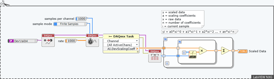

Manually Convert Binary Data to Scaled Data:
Using the Device Scaling Coefficient property, you can convert the binary data to scaled data using a setup similar to the one below.
