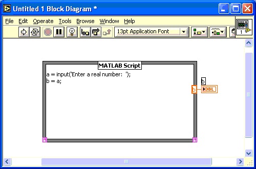

Commands such as input require the user to interact in the command window of MATLAB. They will not properly run in the MATLAB Script Node in LabVIEW. The following is a screenshot of a MATLAB Script Node that calls the input command.
![](/servlet/rtaImage?eid=ka00Z000000cBEJ&feoid=00N0Z00000HEWRt&refid=0EM0Z000000FTAq)
To fix this problem, associate the variable being assigned the input to a LabVIEW control input on the Script Node
