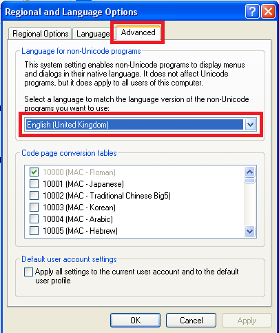

For Windows XP:
  1. Click on Start»Settings»Control Panel.
  2. Double-click on Regional and Language Options.
  3. Click on the Languages tab.
  4. Click on Details.
  5. Click on Add from the Settings tab.
  6. Select the Cyrillic input language (i.e. Bulgarian, Russian, Serbian, etc.) of your choice and click OK. This will bring you back to the Regional and Language Options panel.
  7. Click on the Advanced tab.
  8. Select the Cyrillic language of your choice to match the language version of the non-Unicode programs you want to use.
  9. Restart the PC when prompted.
  10. Start LabVIEW after your PC has been restarted.
  11. Change the Front Panel and the Block Diagram fonts to one of the available Cyrillic fonts (e.g. Arial CYR).
  12. You should be able to type in the Cyrillic language of choice.

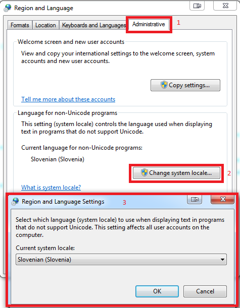

For Windows 7:
  1. Click on Start»Control Panel.
  2. Double-click on Region and Language
  3. Click on the Administrative tab.
  4. Click on Change System locale...
  5. Select the required language from the list and click OK.
  6. You will then be required to restart your PC.
  7. After you restart, open LabVIEW and change fonts to one of the available Cyrillic fonts.

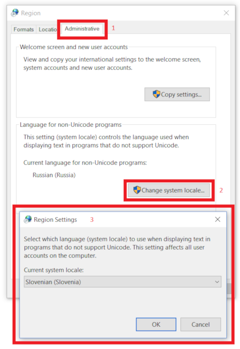

For Windows 10:
  2. Click on Clock, Language and Region.
  3. Click on Change Location
  4. Click on the Administrative tab.
  5. Click on Change System locale...
  6. Select the required language from the list and click OK.
  7. You will then be required to restart your PC.
  8. After you restart, open LabVIEW and change fonts to one of the available Cyrillic fonts.

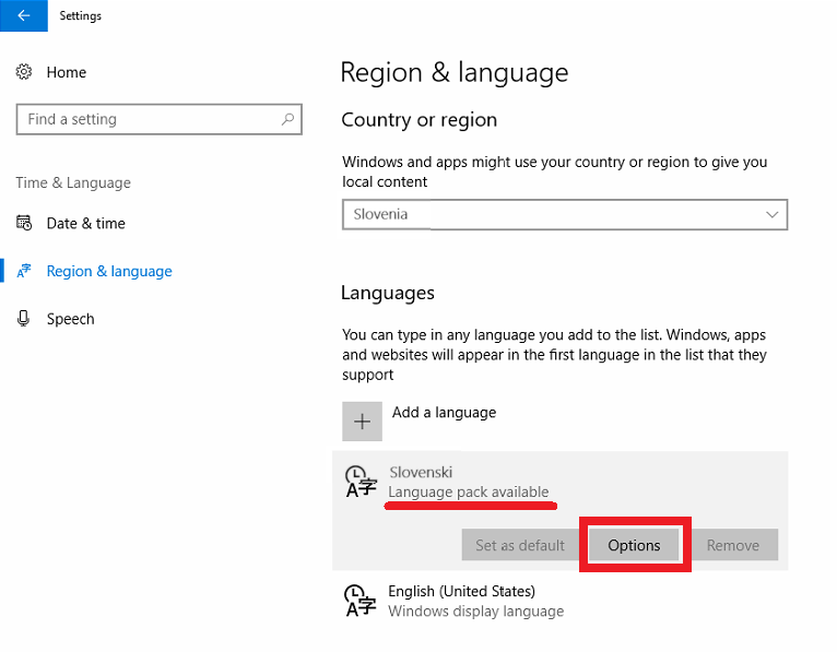

    If language of the Operation system was not changed you may need to download Language Pack in order to apply chosen system locale. To do this:
    1. Click on Start>>Settings
    2. Click on Time and Language
    3. Click on the Region and Languages tab
    4. Click on the Added Language
    5. Click on the Options button
    6. Click on the Download button under Download language pack label
