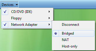

VMware
  1. Navigate to Devices»Network Adapter, then selecting Bridged.
  2. Restart your virtual machine for the setting to take effect.

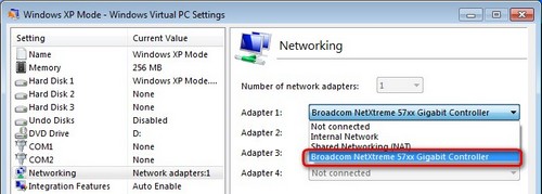

XP Mode Feature in Windows 7
  1. Navigate to Tools»Settings, then select Networking.
  2. Change the adapter settings from the default of Shared Networking (NAT) to the ethernet controller on your computer, as shown below:
If you are unable to connect to your VLM server running on your virtual machine, one possible cause is the default Windows firewall settings of your computer image.
