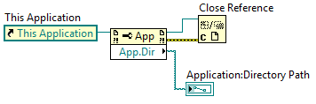

  • For LabVIEW versions prior to 2009, you can use an application property node to programmatically determine in which environment you are running, and based on that strip the path either once or twice. In the screenshot below you can see how to accomplish this.
  • Another option is to use the Application Directory property node in order to find the running directory of an executable.
Note: the leftmost VI is Open Application Reference, not Open VI Reference. Also, since this property searches for running LabVIEW executables, during development this property returns the path to your current instance of LabVIEW.
