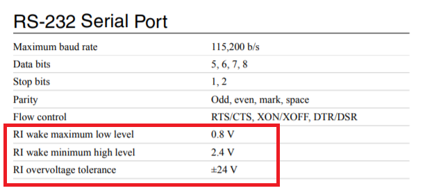

If you have a device with a Ring Indicator line on its serial port, like the cRIO 903x and 904x, you can wake your device and restart it's RTOS using this line. Otherwise, you will need to manually power the device back on.
