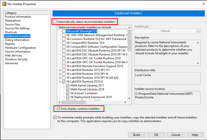

Beginning in LabVIEW 2015, application builder enhancements were added so that the Additional Installers page of the Installer Properties dialog box includes the new Only display runtime installers checkbox, which filters the run-time installers to display. Place a checkmark in this checkbox to view run-time installers only. This option is enabled by default.
LabVIEW 2013 and 2014
In LabVIEW 2013, application builder enhancements were added so that LabVIEW automatically selects installers for the drivers and other software components required by the built application. The user may still choose to add NI installers, just as explained in 8.x versions below. Unlike earlier versions, you must remove the checkmark from the Automatically select recommended installers checkbox on the Additional Installers page of the Installer Properties dialog box for your installer. When the checkbox is disabled, the Run-Time Engine should still be selected. Other drivers will then be available to include. Like LabVIEW 8.6 to 2012, the Installer source location field is not editable.

In LabVIEW 8.x, you can include other NI installers, such as NI-VISA, NI-DAQ, etc., with your LabVIEW application installer, as long as they are already installed on your development machine. Inside of your LabVIEW application's installer, select the Additional Installers heading in the Category toolbar. Select the desired installers to bundle with the LabVIEW application installer.
LabVIEW requires the additional installer’s source MSI and .id files that were used for installation on the development machine to be able to install the additional installer on other machines. These source files are not usually left on the development machine after installation. The Installer source location field tells LabVIEW where to find these needed source files. LabVIEW will, by default, set this field to the last location used to install the additional installer on the development machine. If you installed your additional installer from a CD, you will need to put that CD into your drive before building your installer. If you downloaded the additional installer from ni.com/support and deleted the source, you will need to download the same version and unzip it again before you build and point the Installer source location field to this new folder. If you installed from a network location, you will need to still have access the files on the network drive or one of the two above options.
