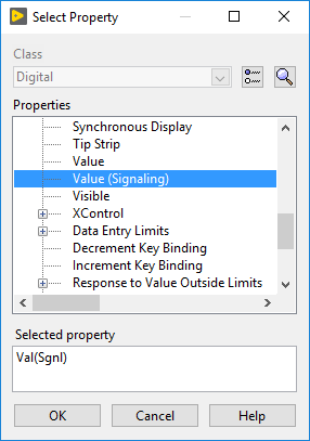

There is one exception: Events for changing controls and indicators can be generated programmatically with a Property Node, using the property Value(Signaling)  (in short: Val(Sgnl)), as shown in the figure below.

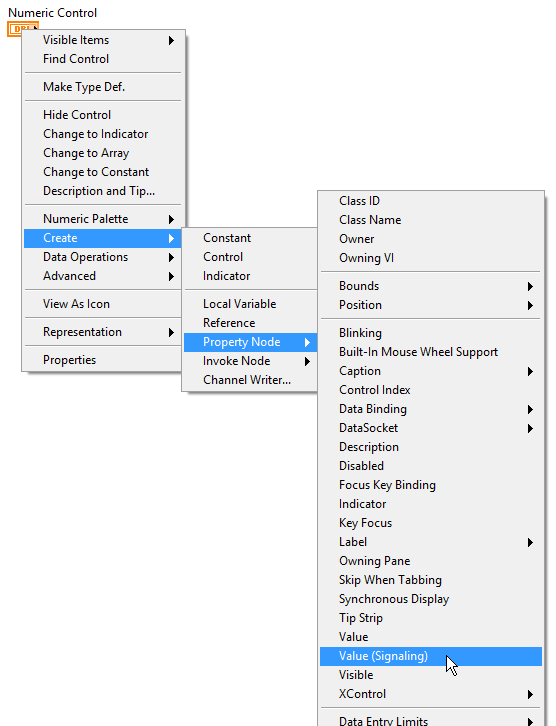

It can be created by right-clicking the terminal of a control or indicator, then navigating to Create » Property Node » Value (Signaling)
When data is written to the write-only property, the value of the referred indicator/control is updated, and an event is fired as if the Front Panel value was changed by user interaction. Be aware that the event is fired every time data is written, regardless if the value was overwritten by the same value. For example, if this property is used inside a loop, it will generate a Value Change event for each iteration, regardless of whether the value was actually changed.

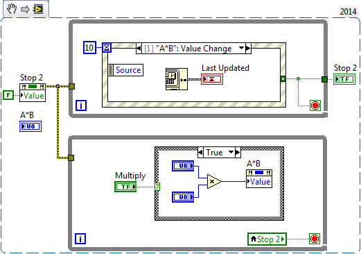

This VI uses the Val(Sgnl) property to update the indicator as well as to generate an event. When the "A*B" indicator is updated, the Event Structure will register the event and update the "Last Updated" Indicator with the current time.
In contrast, see the figure below for a demonstration about Value Change event using Value property.
This VI uses the Value Change property to update the Indicator. When the "A*B" indicator is updated, the Event Structure will not detect the event as there is no event.
In both VIs, the product is written programmatically to the indicator "A*B.". Both VIs also have an Event Structure meant to capture a value change event of the "A*B" indicator. Only the VI using the Value (Signaling) property will register an event when the "A*B" indicator is updated.
