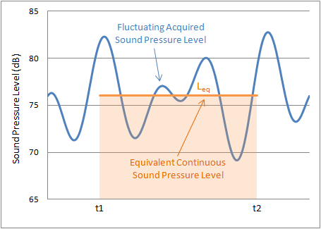

NI Sound and Vibration Software has a VI named SVL Leq Sound Level.vi that returns a value called Leq sound level [dB EU]. What is Leq sound level and what does it represent?
Leq represents a value known as Equivalent Continuous Sound Level. Usually the sound pressure level (SPL) you are measuring varies in amplitude over time. Leq, on the other hand, is the imaginary constant SPL that would produce the same energy as the fluctuating sound level you are measuring over a given time interval.
The equation to calculate Leq divides the integrated, normalized sound pressure by the duration of interest of the signal. The result is expressed in units of decibels:
  • Leq = equivalent continuous sound pressure level in dB
  • p0 = reference pressure level (typically 20 µPa)
  • pA = acquired sound pressure
  • t1 = start time for measurement
  • t2 = end time for measurement
