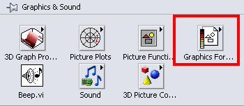

I have an array of pixel data that I would like to convert to the Image data type to display it on my Front Panel and/or save it to a JPEG, PNG, or BMP file.
Is there a way to do this if I do not have the IMAQ ArraytoImage or IMAQ ArraytoColorImage VIs which are only available with the NI Vision Development Module?
Although there is not a way to convert the array of pixel data back to the Image data type that is used by the IMAQ VIs and the Image Display control, there is a work around that will allow you to convert the data into a Pixmap.
The Pixmap data can then be used with the Picture Control to display the image or save to file with the VIs found under Programming»Graphics & Sound»Graphics Formats on the Functions Palette.
VIs on Functions Palette
