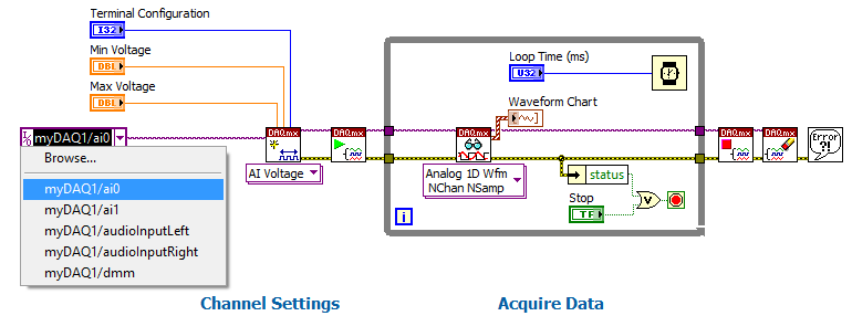

2.Using the myDAQ Programmatically
NI-DAQmx is the driver that you will need if you would like to programmatically control or automate measurements with your myDAQ.
The Analog Inputs, Stereo Inputs, and DMM are all channels that are available as physical channels for an Analog Input task. An example of one of these is shown below:
If you would like to use your device with ELVISmx, you will also need to install NI-DAQmx .
