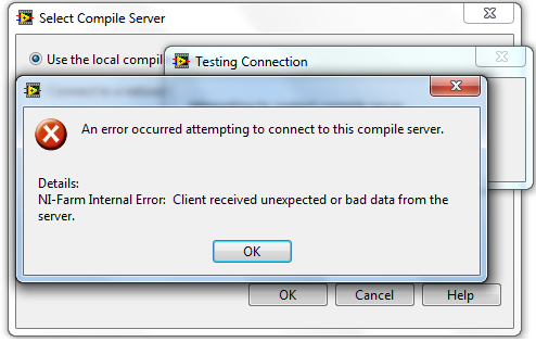

When I try to compile my FPGA VIs, I keep getting one of the following errors:
  • Error -123206: NI-Farm Internal Error.
  • An error occurred attempting to connect to this compile server. Details: NI-Farm: Client received unexpected or bad data from the server.
  • The compile farm server returned an unexpected software error.
How can I resolve this?
