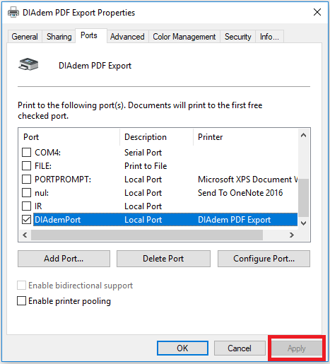

  • There have been cases in which a change of the printer's port was necessary. If the previous steps did not work, try the following:
(Solution is given for Windows 10, steps can slightly differ for different versions of Windows):
  1. Log in as Windows administrator
  2. Go to Settings, Printers & scanners
  3. Click on DIAdem PDF Export, select Manage and click on Printer Properties
  4. In the new window, select Ports and click the Add Port button
  5. Select Local Port and click New port
  6. Enter a port name, e.g. DIAdemPort, and click OK
  7. Make sure the new port is checked and click Apply
  8. Restart the computer to make sure all changes take effect

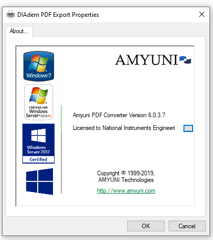

DIAdem uses a third party tool named Amyuni PDF Converter. Newer versions of DIAdem may use newer versions of Amyuni PDF Converter which may not be compatible with older DIAdem versions. You can check the installed version by going to REPORT>>Print>>Printer...>>DIAdem PDF Export>>Properties:
