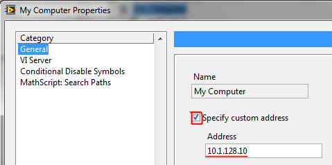

The IP address also needs to be changed to reflect the IP address of the desired network card under the My Computer settings in the LabVIEW Project Explorer.
Right-click on My Computer within the LabVIEW Project Explorer, click on Properties. Under the General tab, click the Specify Custom Address checkbox, and enter the IP address of the network card that the shared variables will be deployed to.
