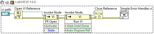

When you use the Run VI method, you are not required to use a strictly typed reference. As a result, you can pass any VI reference to this method to run it. Using the Run VI method allows for more flexibility, as it allows you to call VIs that do not have the same connector pane. This is a simple way to only open the Front Panel and run a VI. However, if you want to pass values, you will need to know the names of the Controls and their data types, which requires additional programming. The Run VI method becomes more flexible because you can pass any VI path into this setup and it will be able to open and load that VI.
Another benefit of using the Run VI method over calling a VI by reference is the ability to interact with the VI. The Run VI method allows you to interact with the VI while it is running, e.g. if it needs to be controlled or in case the outputs need to be read multiple times. Using the Call by Reference node, the connector pane will output values only once, when the VI finishes execution. It does not provide the capability to interact with a running VI.

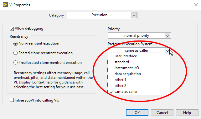

Using the RunVI method may have the target VI run in the UI thread, which can lead to some issues if you want to have the calling VI perform adequately while the called VI is running. This happens even if you have a False constant wired to the Wait Until Done terminal. For a complete asynchronous call outside of the UI thread, you need configure the target VI's execution settings accordingly. Open the target VI, and go to to FileĀ»VI Properties, select Execution in the drop-down and choose a Preferred Execution System different than User interface and Same as caller.
