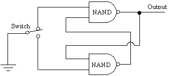

Presented below are two of the many methods used to de-bounce a mechanical switch
SR Flip-Flop De-bouncer
You can use a latch or an SR flip-flop to eliminate signal bounce or noise caused by the switching of a mechanical device (switches, buttons etc.). When the switch occurs, only one input is affected immediately before stabilizing. This is followed by the second input bouncing before the contact stabilizes. Both inputs are never bouncing at the same time so the output of the latch will never change due to signal bounce. Directly below is a schematic for a latch de-bouncing circuit.
