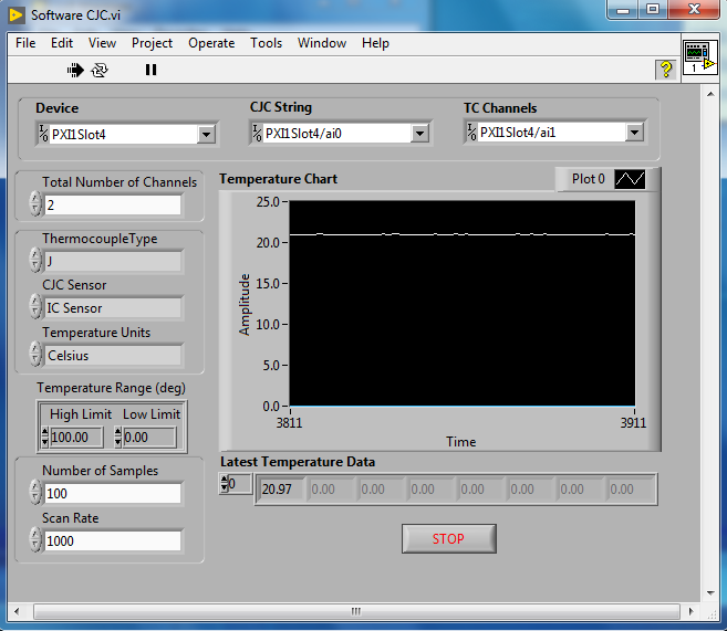

Using LabVIEW:
  1. Use the Software CJC.vi inside the softwarecjc.llb provided inside the link in the Attachments Links section to perform the measurement.
  2. According to the hardware configuration mentioned previously, the front panel configuration is shown in the screenshot:
