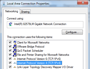

  1. Go to Start»Control Panel»Network Sharing Center»Change Adapter Settings.
  2. Right-click on the Local Area Connection associated FieldPoint connection, and select Properties.

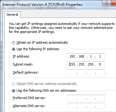

  3. In the Local Area Connection Properties window, select Internet Protocol Version 4 (TCP/IPv4), and click on the Properties button.
  1. Select Use the following IP address and enter an IP address and Subnet mask. For this example, we will use the IP address and Subnet mask shown in the figure below. With these settings, the subnet is 192.168.1.0.
  1. Leave the other fields blank, and click OK and then Close.

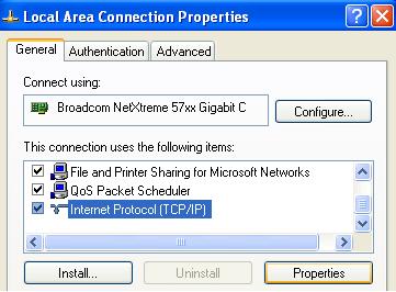

  1. Go to Start»Control Panel»Network Connections.
  2. Right-click on the Local Area Connection associated FieldPoint connection, and selectProperties.
  3. In the Local Area Connection Properties window, select Internet Protocol (TCP/IP), and click on the Properties button.

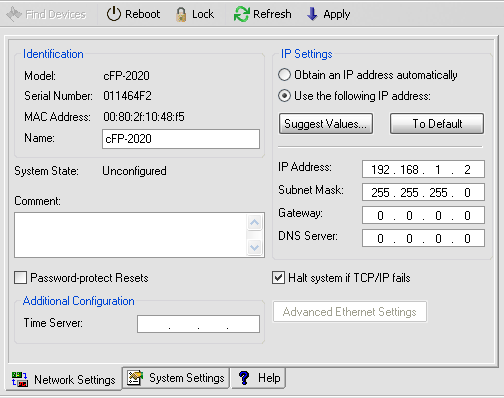

  4. Click on the unit in remote systems, and select the Network Settings tab in the bottom center.
  5. Select Use the following IP address under IP Settings, and type in the IP address and Subnet mask.
