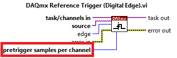

Configuring a Reference Trigger
Reference triggers require an additional input parameter called pretrigger samples per channel:
Figure 2:  Pretrigger Samples Parameter in LabVIEW
The number of pretrigger samples defines how many of the total samples acquired during the finite acquisition are from before the reference trigger occurred.  The rest of the samples in the acquisition are considered post-trigger samples.
Implicitly, the number of post-trigger samples is equal to:
Post-Trigger Samples = samples per channel (DAQmx Timing input) - pretrigger samples per channel (DAQmx Trigger input)
For example, to configure a task that will acquire the minimum number of pretrigger samples (2), followed by 40 post-trigger samples, you would use 42 for samples per channel as an input for DAQmx Timing, and 2 as pretrigger samples per channel on the DAQmx Reference Trigger.  The final output of the finite acquisition would look like so:
