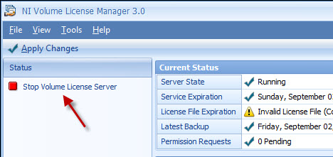

  2. On the server, open NI Volume License Server and stop the server from running.

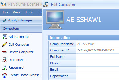

  3. Reconnect the disconnected license so you may edit it's computer ID. Click the Computers or Users tab on the left hand pane depending on which type of disconnected license is being utilized.
  4. Click Edit Computer/Edit User and compare the computer id/username shown here (the server) to the previous computer ID/username which was taken from the client machine. Make sure that the client ID/username is correctly copied to the server.
  5. Click Save within the Edit Computer or Edit User window and then click Apply Changes in the upper left hand corner of NI Volume License Manager on the server.
