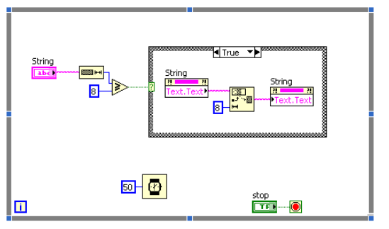

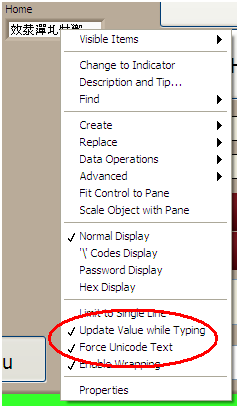

Some crashes on LabVIEW were reported when modifying the text in strings controls after enabling Force Unicode Text and  Update Value while Typing properties from the context (right-click) menu
To avoid this behavior, try to Limit input string length using the following approach:
