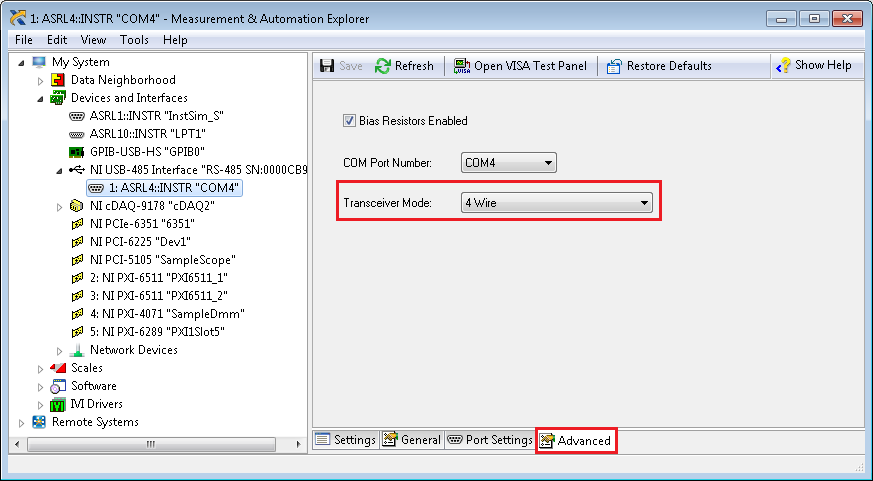

MAX
Note: Some users may find that the Advanced tab is not visible in NI‑MAX. This is a known issue in certain NI‑MAX / NI‑Serial versions. When this occurs, RS‑485 wire mode cannot be configured in NI‑MAX. The current recommended workaround is to set the transceiver wire mode programmatically (for example, using NI LabVIEW), as described in the next section.
This option allows you to set the wire mode in MAX first before any application development.
  1. Ensure you have administrator privileges on your computer account.
  2. Search for NI MAX in the Start Menu and right click >> Run as Administrator.
  3. Expand Devices and Interfaces and select the RS-485 serial port of interest.
  4. Select the Advanced tab at the bottom of the window.
  5. Select the desired wire mode from the Transceiver Mode drop-down menu.
    • 4 Wire is also known a Full-Duplex, which allows for simultaneous bi-directional communication.
    • 2 Wire is also known as Half-Duplex, which switches between transmitting and receiving over a single connection.
    • Refer to Duplex Architectures for further information.
