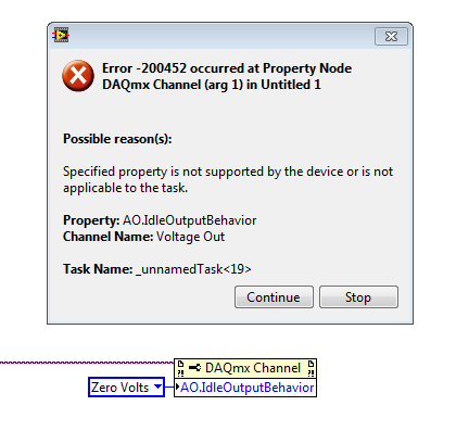

  1. I am trying to configure properties using different DAQmx property nodes, such as AO.IdleOutputBehavior, Start.Retriggerable or CI.DutyCycle.DigFltr.Enable, and I am getting an error -200452. How can I set up my trigger behavior or set other properties like the Idle Output Behavior?
  2. I have defined a DAQmx Channel property, such as CO.Pulse.Freq.InitialDelay, which works fine, but I am receiving the following error:
    Error -200452: Specified property is not supported by the device or is not applicable to the task.
The different properties of DAQmx property nodes are device-specific. Not all properties are supported by all DAQ devices. For example, the AO.IdleOutputBehavior property is not supported by either NI 6251 or NI 6040E, so Error -200452 will be returned whenever this property is called for these devices.

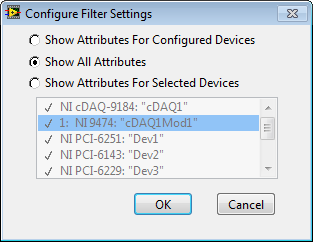

In order to look at only those properties that are supported with your particular DAQ card, you will have to configure the filter settings of the property node. You can do so by right-clicking on the DAQmx Channel Property and selecting Select Filter... to open the Configure Filter Settings window to filter out properties that are not supported by your device from the list.

If you don't already have the device installed on your computer, one simple way to determine if a certain property is supported by a device is to simulate the device in Measurement & Automation Explorer (MAX). To do this, right-click the Device and Interfaces folder in MAX and select Create New. In the Create New window, select NI-DAQmx Simulated Device, and then set the Property Node's filter setting to Show Attributes For Selected Devices. If the board supports the property you are looking for, then it will show up as one of the options for any given property node that references the board.
