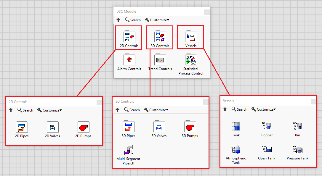

I can't find the pipe, pump, vessel or valve controls/indicators in the LabVIEW palette. I'm trying to add more of theses indicators to an older VI, but can't find them.
You must download and install the Datalogging and Supervisory Control (DSC) Module to access these custom controls and indicators. These custom indicators will appear in the Front Panel palette after the DSC module installs.
The computer on which the older VI was created had this module installed. Once you install this module, you will find the controls/indicators in the palette under the DSC Module category. Once you open this folder, use the image below to locate the specific control or indicator you are interested in.
