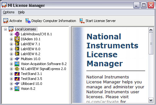

The NI software installed on your machine that is not available for free is listed in the NI License Manager. This can be found by navigating to Start Menu»Programs»National Instruments»NI License Manager
NI License Manager 4.0 and later:

Earlier Versions of NI License Manager:
Each piece of software listed under Local Licenses will be expandable and list the possible license options that can be activated.
For example, with NI TestStand 3.5 there are three different license options: Base Deployment Engine, Debug Deployment Environment, and Development System.

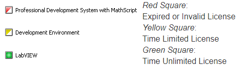

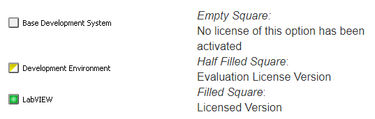

Depending on which type of license is installed, different colors will appear in the boxes next to each license possibility for the given software. In the image above, TestStand 3.5 Development System Time Limited Evaluation Version is installed. There are 3 different colors and 3 different square filling possibilities.
Square Filling Scenarios
Square Color Possibilities
More information on the meaning of these icons can be found in the License Manager Help (Help»Contents) under NI License Manager Help»License Management Overview»The NI License Manager Environment.
