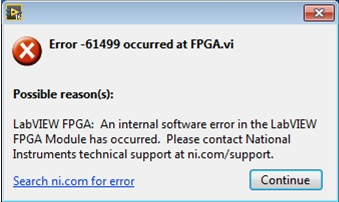

  • I am getting Error -61499: LabVIEW FPGA: An internal software error in the LabVIEW FPGA Module has occurred in an FPGA VI at compilation time or while editing a VI.
  • I get Error -61499 while editing an FPGA VI. The error refers to specific FPGA nodes, in my case, the Open FPGA VI Reference vi causes the error when I place it from the palette.
  • An additional message may be attached saying : "Additional Information: Unsupported or incorrectly typed FPGA Device Family. Use lower case letters only", and may appear from configuration in the Getting Started Projects for RIO.
