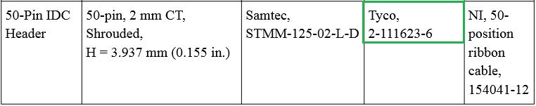

I cannot find the corresponding mating connector for the 50 Pin IDC Connector on my NI 9697 Mezzanine card. Which mating connector is recommended by National Instruments?
The recommended mating connector for this is the same as for the IDC Connector on the NI sbRIO-9637. National Instruments recommends using the Tyco product number, 2-111623-6. This can be found in the NI sbRIO Connector Descriptions (page 18) section of NI sbRIO 9637 manual. The below image shows the excerpt of the manual.
You can order a mating connector for the RMC connector from Tyco the connector manufacturer, or from a distributor such as Arrow or Avnet.
