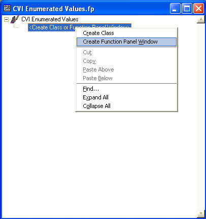

    2. Create a new function panel window

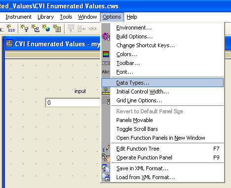

  1.  Define your enum as a new data type by selecting Options » Data Types, entering the name of your enum, and then adding it to the list.

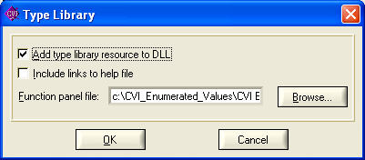

  2. Include the function panel as a type library for you DLL by navigating to Build » Target Settings and clicking the Type Library button. Then enable the Add type library resource to DLL option and browse for your .fp file. Click OK twice to accept the DLL build settings.
