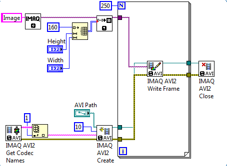

If you would like to see an example of this in action, please use the code below to create an AVI file, and read that written file with the Read AVI File.vi located in NI Example Finder under Toolkits and Modules»Vision»Files.  The written AVI file should appear as a blank gray video file if working, and will be black if it cannot be read.

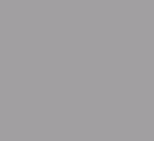

The working compressed file will look as follows:

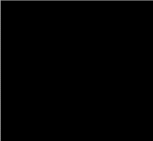

The non-working compressed AVI file will appear like this:
This problem can be associated with how the video file is sized as well as how it is compressed.  For an MJPEG compressed video, if the pixel height is an odd number and is greater than or equal to the video width (both of which must be greater than a pixel value of 291), the file will display as a black video.
What causes this is that the MJPEG file compression format results in files being created that cannot be read by our software unless the pixel height is a multiple of two or the file size is under a certain limit.
