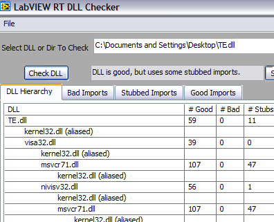

Use the attached utility to determine whether or not the function calls in your DLL are supported on the real-time operating system. Use the version of the utility that corresponds with the version of LabVIEW Real-Time you are using.
Note: The same version of the utility can be used for LabVIEW Real-Time 2015 and 2016.
There are three categories that functions are sorted into: Good, Stubbed, and Bad (as shown below).
  • Good indicates that the function is supported on the real-time operating system.
  • Stubbed means that calling the function will not cause a deployment error, but the operation has been removed and will return a default value. Code dependent upon proper outputs from stubbed functions may not execute as expected.
  • Bad means that the function has not been exported to the operating system. You cannot deploy code calling unexported functions.

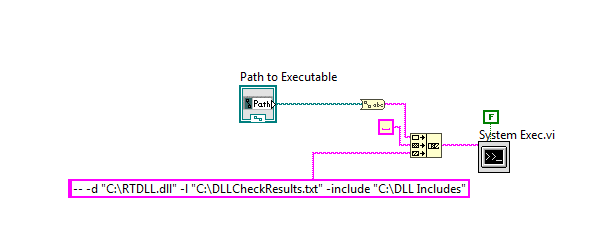

Automating the DLL Checker
For versions 2013 and later the DLL Checker executable can now be called with additional arguments which specify the DLL to check and the path in which to place a log file with the results. This allows users to automate the check process using a batch script or a program that can invoke the command line, such as LabVIEW.
The argument to pass is:
-- -d "<path to dll>" -l "<path to log file>" -include "<path to DLL includes>"
Here is an example of automating the check in LabVIEW.
-d "<path to dll>" - This flag specifies the path to the DLL you are checking.
-l "<path to log file>" - This flag specifies the path where resulting logs for the check will be stored. If the log file specified in the arguments path does not already exist on disc a new file will be created using the name specified.
-include "<path to DLL includes>" - By default, the DLL checker only checks the main DLL you specify with the -d flag. In order to check dependent .dll's the -include flag should be used. Use this flag to specify the directory for any other .dll that the DLL checker should also check.
