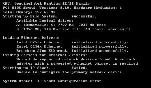

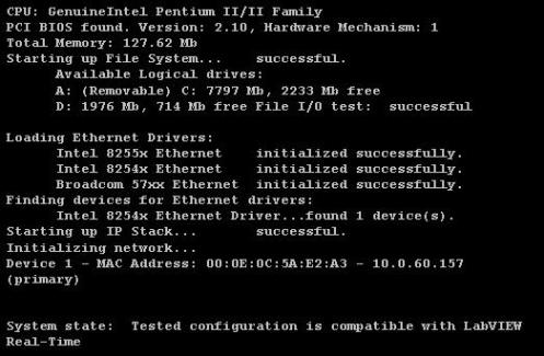

  5. The utility will then begin testing your system.  If you pass the test successfully, then you should see a similar result as shown in Figure 1. If the PC cannot be converted to a real-time system, you will see an incompatibility result. An example is shown in Figure 2.
Figure 1: Real-Time Desktop PC Evaluator Passed Test
Figure 2: Real-Time Desktop PC Evaluator Failed Test (incompatible chipset)
  • The most common incompatibility is the ethernet chipset.
  • If the PC evaluator fails without reporting an error, then try changing BIOS settings according to the manuals available for your hardware. Otherwise, the evaluator will report on common errors such as non-FAT32 or Reliance file systems.
  • If the program stalls at TRANSFERRING CONTROL TO USER PROGRAM, try updating the BIOS of the system to the latest version.
