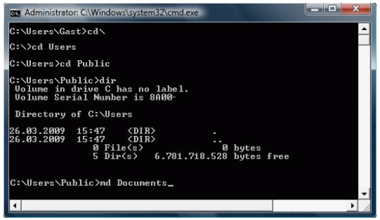

If this folder does not exist, continue with these steps by typing the following (see picture below):
  • Create a new documents folder: md documents
  • Verify, that the folder was created successfully: dir
