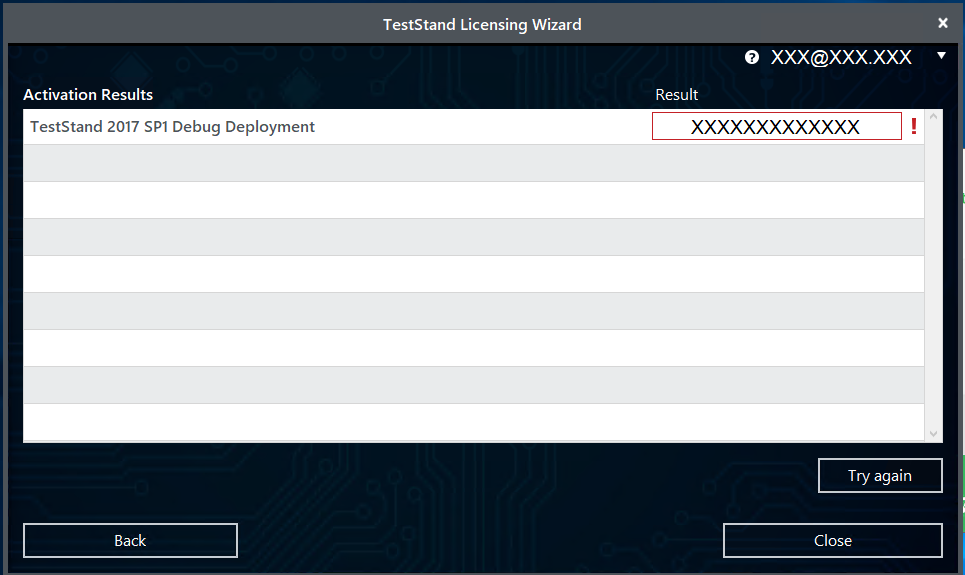

  • After entering my serial number in the Licensing Wizard it asks me to try again, as shown in the image below.
