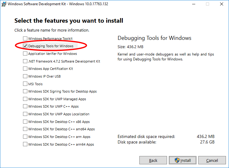

  1. To obtain the tool, download one of the following installers:
  2. Execute the installer if SDK downloaded, check only Debugging Tools for Windows.

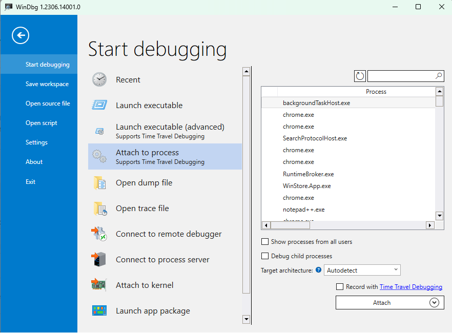

  1. In WinDbg, select File » Attach to a Process.
  2. Select your application's process from the Process List. Selecting Sort » By Executable to alphabetically sort the process list can help finding your process. In case you are running your application in the LabVIEW Development Environment, search and select LabVIEW.exe, Enerchron, or application. Click Attach/OK.
windbg preview attach to file process
  1. A command line window will appear in the main WinDbg application. For old Windows Dbg, select Debug » Go, else will start automatically.

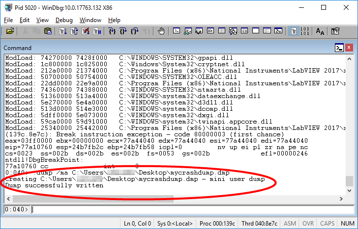

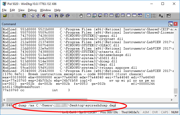

  1. Create a dump file by typing the following command into the prompt at the bottom of the WinDbg window: .dump /ma C:\[path]\filename.dmp. Use a path you have writing access to, e.g. your local desktop.
  1. WinDbg will need some time to write the dump file. Check for any error or success message in the WinDbg window afterwards.

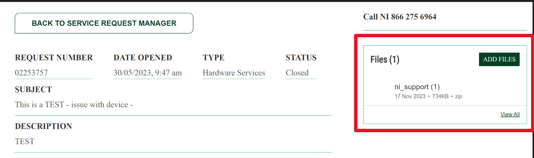

The dump file created by WinDbg may be used by NI to further pinpoint the origin of LabVIEW, TestStand, Enerchron, or other NI software process exceptions. As a typical dump file is several hundred MB in size, you cannot attach it to an email to NI Support. Instead, visit ni.com/ask and upload the file to your support ticket under the files section.
