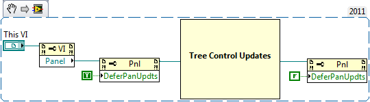

  • Enabling Defer Panel Updates greatly increases the speed of adding items to tree controls. Defer Panel Updates increases speed because it defers updating the front panel for changes in values of controls and indicators.

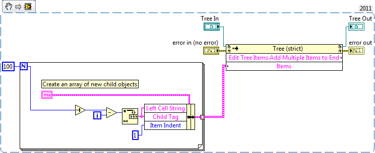

  • Another useful method introduced in LabVIEW 8.0 is Add Multiple Items to End, which allows the addition of multiple items at once. By bundling all the items together and writing once, Add Multiple Items to End saves time. If you get Error 1088 make sure your tree control has at least one item before adding new childs or change the Item Indent to 0.
