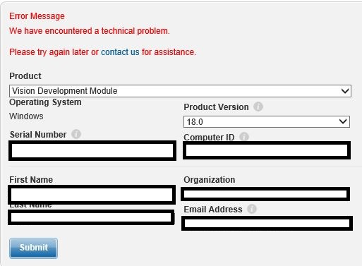

Technical Problem During Activation
If you see an error message similar to the following when activating using your serial number, try going to ni.com/activate and generating an activation code, and then activating using that code.
Error Message
We have encountered a technical problem.
Please try again later or contact us for assistance.
