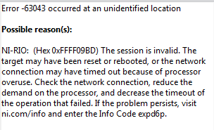

I'm getting error -63043 in my LabVIEW program:
Sometimes the remote target (cRIO) loses connection to my network when I get the error message above. I have to manually restart it to make it connect to the network again. How to fix this error?
To prevent this error from occurring, the timeout period for RIO Server RPC connections of the cRIO controller needs to be increased. With NI-RIO 2.3 or later, it is possible to modify these settings manually in the nirio.ini file.

  • In nirio.ini, increase the following INI settings:
    • [General]
    • RpcTimeout = 15
    • RpcSessionTimeout = 300
    • DeviceDiscoveryTimeout = 10
      • Note: These values are the defaults and are in seconds (e.g. 300 means 5 minutes).
      • Refer to the Additional Information section for more explanation of these settings
There are many reasons which may lead to this error. If editing the timeout values doesn't take an effect, please check the following article for further troubleshooting.
