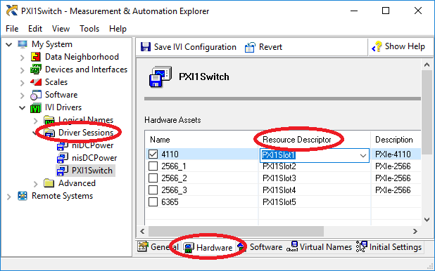

For NI Switch Executive, the resource descriptor is in the IVI Driver Session on the Hardware tab. Double-click on the Resource Descriptor to change it.
Note: The Resource Descriptor dropdown menu will only display the VISA resource descriptor; the DAQ/DAQmx resource descriptor will need to be manually entered.
Refer to the "Hardware Asset" section of the Measurement & Automation Explorer Help for valid resource descriptor options. The help can be accessed within Measurement & Automation Explorer (MAX) under Help»MAX Help
