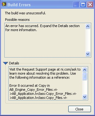

  • I am trying to create an application using the LabVIEW Application Builder Module but I'm unable to, due to writing permissions on my C:\Program Files(x86)directory. I am getting the following message in the error file:
This error can be due to an option selected while setting up the build for your executable-Copy error code files in the Advanced section of Application Builder. Copy error code files adds copies of XML-based LabVIEW error code text files from the project\errors and user.lib\errors folders to the run-time engine.
  • When I try to create an application using the LabVIEW Application Builder Module, I get the following error message:
The build was unsuccessful.
Possible Reasons
An error has occurred. Expand the Details section for more information.
Details
Visit the Request Support page at ni.com/ask to learn more about resolving this problem. Use the following information as a reference:
Error 8 occurred at Copy in AB_Engine_Copy_Error_Files.vi->AB_Application.lvclass:Copy_Error_Files.vi->AB_Application.lvclass:Copy_Files.vi-...

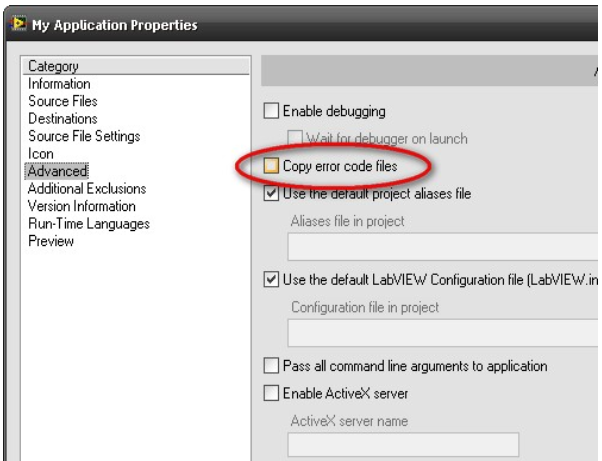

  • If the application is attempting to write files to C:\Program Files (x86), ​​​ complete the next steps:
    • From the Project Explorer view, right-click Build Specifications. Select New»Application (EXE).
    • Select the Advanced category of Application Builder and uncheck Copy error code files option as shown below:
      • Disabling this option prevents the Application Builder from writing error log files to the C:\Program Files (x86) directory
    • Rebuild the application and observe if the error was solved.

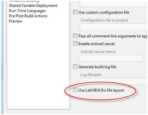

  • For VI's built in LabVIEW 8.5 that have been compiled to LabVIEW 2009 or higher, uncheck the Use LabVIEW 8.x file layout option in the Build Specifications as shown below:
