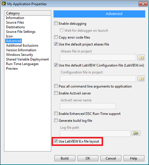

  • For an application or shared library builds, place a checkmark in the Use LabVIEW 8.x file layout checkbox on the Advanced page of the build specification Properties dialog box.

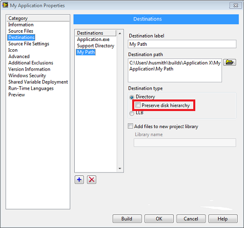

  • For a source distribution or web service builds, uncheck the Preserve disk hierarchy checkbox on the problem on the Destinations build specification page located under the Destination type.
