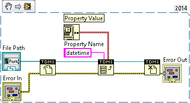

Most of the default TDMS file properties can be set using the TDMS Set Properties VI . Below are tables that contain the various properties that can by modified in your TDMS file and viewed using a TDMS file view such as Microsoft® Excel.

 Date/Time datetime Time Stamp
